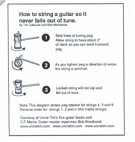

I have never noticed any weight increase that can be felt. Those old solid Grovers are pretty heavy themselves. The benefit of locking tuners is that the string has no wrap at all around the post. that way there is nothing to hang it up and slip/move therby throwing the string out of tune suddenly. I use the string wrap method when I string my guitars and find that it works almost as good because I never put more than one turn on the post.
PostPosted: Fri Jan 06, 2006 2:45 am
Dave if you do this with locking tunner, would you not defeat the porpose of locking tuners? I am guessing you mean on standard post tuners. Besides the locking tuner would just chop it off anyway.MichaelP38723.449537037
PostPosted: Sat Jan 07, 2006 1:26 am
Sorry bout that...I meant to show what I do with the non-locking tuners to "lock" them best as possible. I had one customer actually hate the locking tuners and went back to reg. Grovers so i showed him how to "lock" those...
